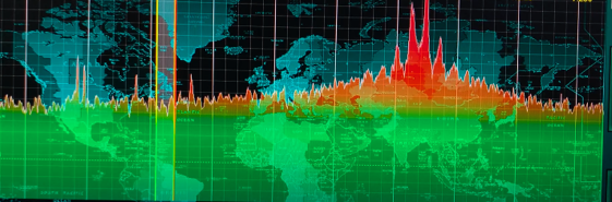

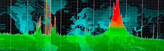

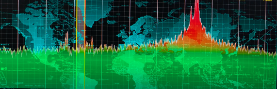

I'd like to ask for advice and possible solutions with regard to a problem that came up over the past few weeks. There is a 1.5kW station not that far down the road from me that operates on a frequency in the 40m about 45 kHz up from me regularly. His signal is causing artifacts across the entire phone part of the 40m band, and beyond. The entire 40m phone band undulates up and down with static crashes and waves of distortion. I have a .mov file which shows what's going on well, but that doesn't seem to be one of the acceptable attachment file types, so I'm settling on a few stills.
Chris, NU6C
Note added: Since it might not be clear from the images, the signal in question is an SSB signal that itself sounds reasonable when I tune it in.

Classic co-channel interference. There's not a lot to be done about it. Cranking some step attenuator in on receive will help a little, but at the expense of weaker signal reception.
It would be interesting to see the entire UI screenshot, with freq's, amplitudes and S-meter shown. And you might consider adjusting your display baseline so that fully half of it is not noise ;)
Another option would be to set up another antenna to use the diversity (really beamforming) feature of the radio. If you can get things arranged so that there is a 20dB antenna pattern null in the direction of your neighbor, that plus 10dB or so of attenuation would make a big dent in things.
I'm not sure how well you know this person. The signal has a lot of IMD (splatter) on it. If you could get him to drive his amp a little less hard that would also help. But, you know, most hams don't feel like they are getting their money's worth unless the power needle stays pinned at 1500W :roll:

w-u-2-o wrote:Classic co-channel interference. There's not a lot to be done about it. Cranking some step attenuator in on receive will help a little, but at the expense of weaker signal reception.
Thanks, this is what I was thinking in terms of interference. I wanted to see what others thought though. I will say that I just watched a Youtube video by Flex Radios Inc and the clear message was that this was not supposed to be possible... based on their simulation.

I looked at the YT video. That's an oldie but goodie. Gerald is 100% correct. Indeed, I normally run my preselector (bandpass filters) in bypass 100% of the time because I often like to look at two different bands.
The other thing to consider is that, in all of the Hermes-derivative Apache designs, there is an LTC6400 differential amplifier immediately prior to the LTC2208 ADC. The LTC6400 will not start to saturate until the total RF input power level is well above +10dBm. Thus that is not a limiting factor, the ADC will overload first.
You are not seeing an ADC overload condition, if that's what you are thinking. That is real splatter coming from the antenna. I wonder what sort of radio and amplifier that station uses.
