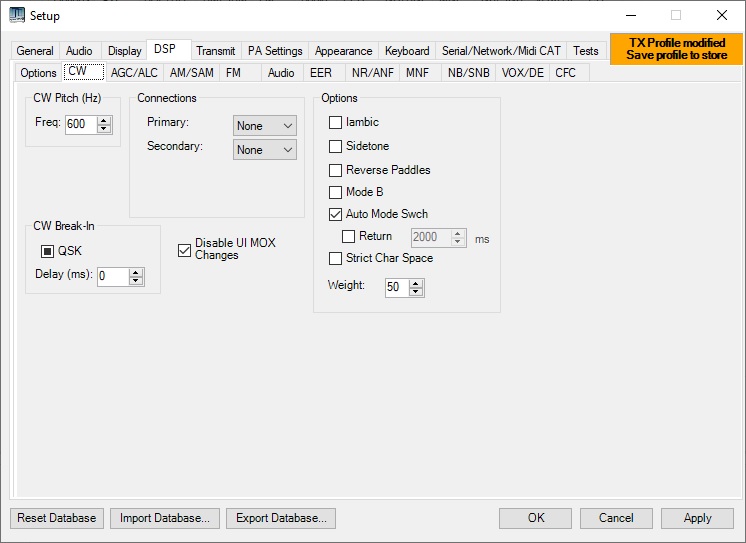

WinKeyer is plugged into KEY, in the front of the radio (just like my paddle was connected before, using the built-in iambic keyer).
Below, see the DSP/CW form as it stands now. Never messed with this form and I have operated on CW without any issues for a long time. Although, I had never used WinKeyer before but the built-in Iambic keyer in Thetis whereas WinKeyer is now used as an external keyer instead.
DSP CW Form.jpg (55.9 KiB) Viewed 11290 times

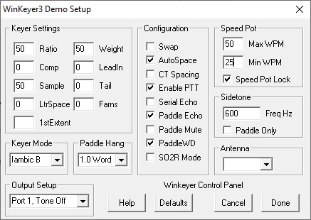

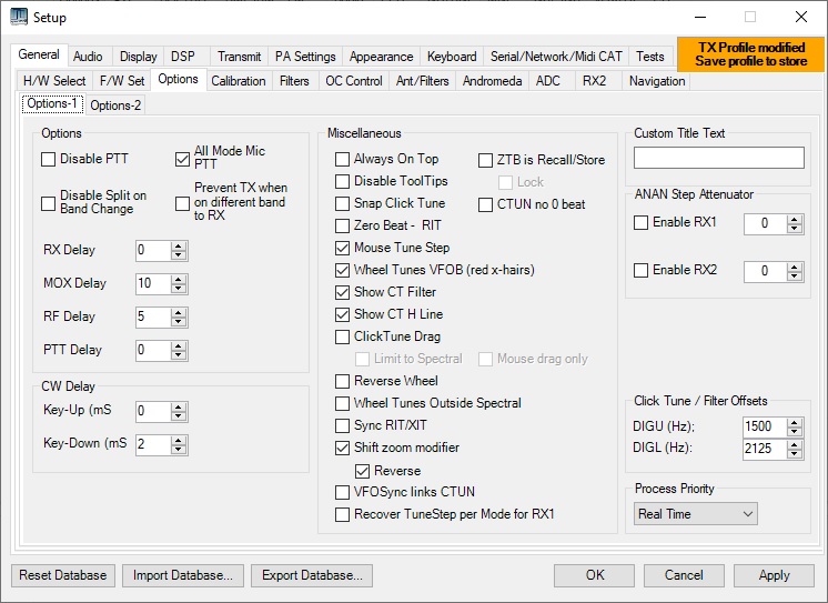

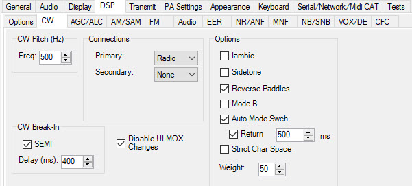

There's no need to use anything but the default Thetis values unless you're trying to extract faster CW performance from Thetis. There are many moving parts between Thetis CW setup values and Winkeyer. I have included my setup screens as a reference. However, I don't suggest that you use the extremely fast times I'm using as shown under GENERAL>OPTIONS>OPTIONS-1. My ANAN 7000 has several hardware QSK modifications to achieve this level of CW performance in an effort to avoid RF hot-switching.
Because of the relationship between Winkeyer timing and Thetis, you really need an oscilloscope as a diagnostic tool when experimenting with a broad range of timing values. It's especially important if you use an external amplifier. Without a scope, you're flying blind.
I use a 4-channel scope with external triggering from a dedicated keyer output. When making system timing changes, I monitor the keyer output line, transceiver RF output, amp PTT line, and amplifier RF output -- each on their own scope input. That gives a complete presentation of what's getting to the antenna and all critical points in between.
Maybe this is all more than you wanted to know, but I hope it's helpful.

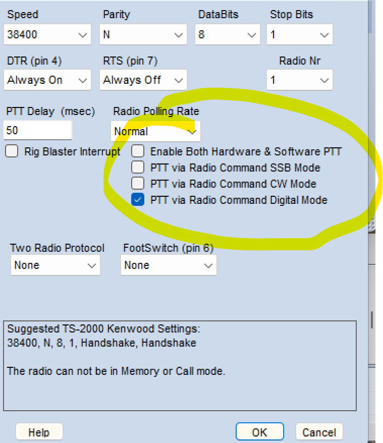

I may have found the problem.
It likely is related to a setting in N1MM+ CAT interface where I had all boxes of the PTT hard and software control ticked.
Screenshot 2024-11-26 120831.png (44.99 KiB) Viewed 5492 times
I was wondering of a relay double click sound when using N1MM+ and realized now that this is related to enabling PTT via Radio Command with different delay setting in Thetis and N1MM+. In fact it also works without enabling the PTT via Radio Command and the double click sound disappeared.
I assume that this caused the hot switching but I only can verify in the next contest.
